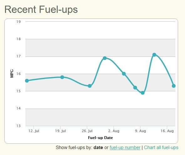

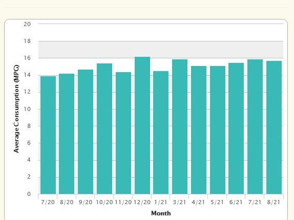

Geez - it's been a year!
I'd say my MPG has * slightly * improved over time. I ran some seafoam through the fuel system about 15 miles before refilling the tank the other day (I just hit 350k miles last week!) - and will run more through as each tank of gas gets low - so it's more concentrated in the fuel system. I try to drive like a grandpa... feather my accelerations, long coasts to traffic lights I suspect are a stale green-light, etc. I traveled from Dallas to San Antonio twice in the last month - and MPPG did increase for those 2 trips - HOWEVER - they were also at higher speeds (Speed limit on toll road 130 is 85MPH - I try to keep the truck to about 70MPH). Also - from SA back to Dallas - I used ethanol-free gasoline (at 90 octane)... I wish we could get it here in the Dallas MetroMess...
My real concern more than anything, now - is the oil consumption. I'm still having to add a qt per appx. 1000 miles. I keep a gallon jug in the truck with me - especially when I'm making long trips. (Here's screenshots of my mileage records from Fuelly.com )
1 year MPG records
last several months records
