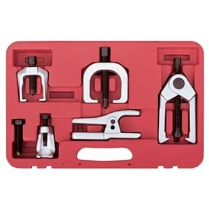

You're talking about this right?
I'd use a puller, or air hammer on the end of the stud. Heck, the pitman arm puller might just work. That or get the thing on the far right of this picture:
V10 has a full front axle, right? Not a cheesy "differential + CV axles" type deal?

The Drag Link attaches to that U shaped component you posted a picture of above and it (Drag Link) attaches to the pitman arm which inturn attaches to the steering box.
As I posted earlier. You can back off the castle nut then use a hammer.
Or use a knuckle puller.
