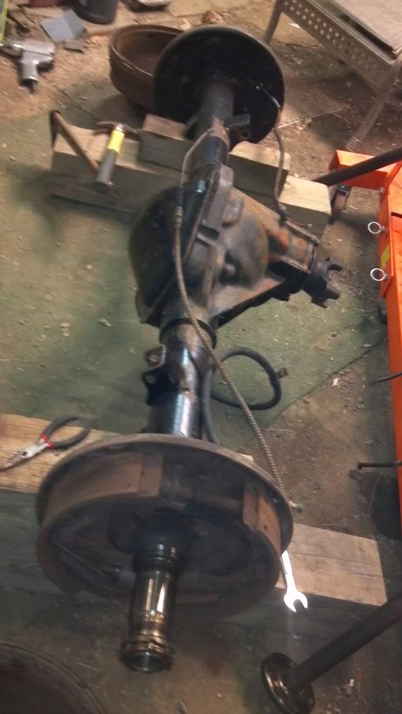

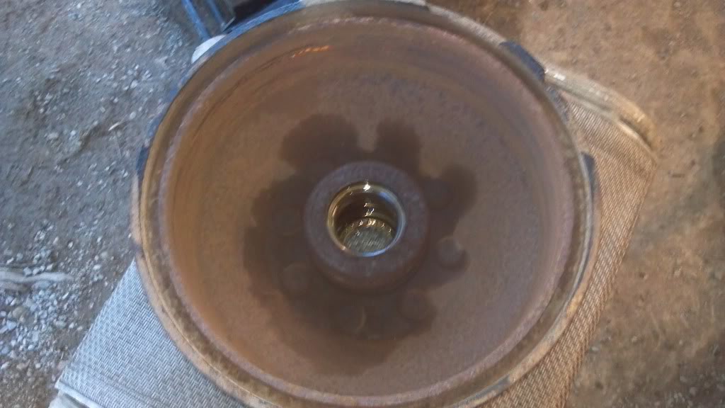

Didnt have much to do today and it was pretty nice but i got the cab off the 86 frame and moved my 14bolt in the garage and pulled the drums off. The plan for it is to keep the 4.10 gears get a locker, and the drums are not in real bad shape so ill prob turn them down on a brake lathe make sure there true and just throw some new pads and hardware on. It already has brand new wheel cylinders from before i bought it.
Id like to do disk brakes but i figure if i can get away with something that still works good and is pretty cheap i will do that if i feel the need for disks later on i can always upgrade.

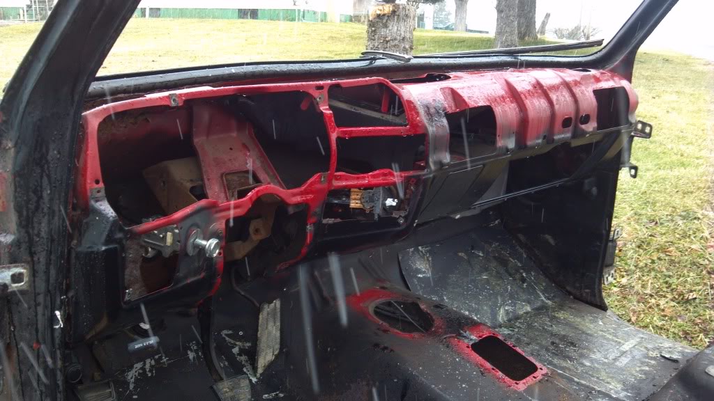

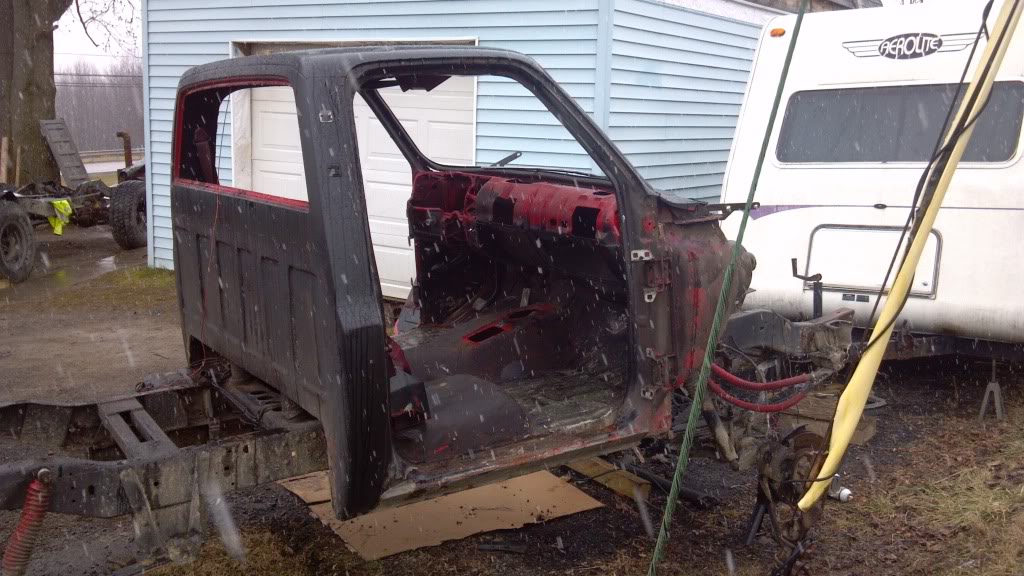

Got my black truck mostly torn apart, im going to have my buddy come get it today or tomorrow to go to scrap hes buying this and he bought a parts cavalier i had and hes giving me a good deal on a D60 axle.
But as soon as i pull the heater box and steering box off im going to have him come get it then i can go pick up my dana 60

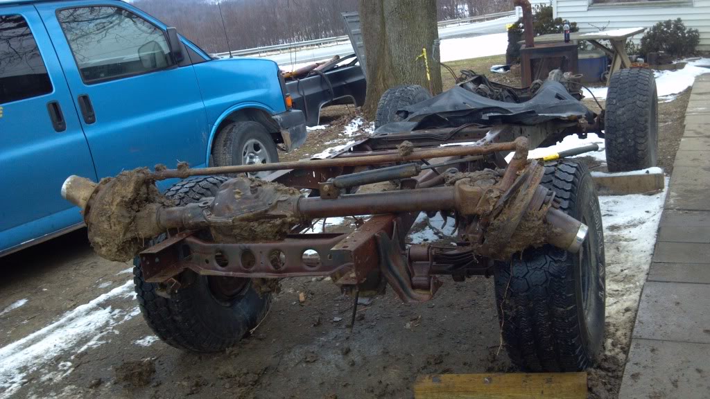

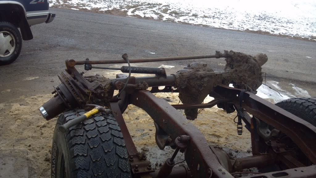

I really really hate frozen mud. I should have cleaned it last night before it froze hopefully it warms up some so i can clean it my pressure-washer barley even touches it.

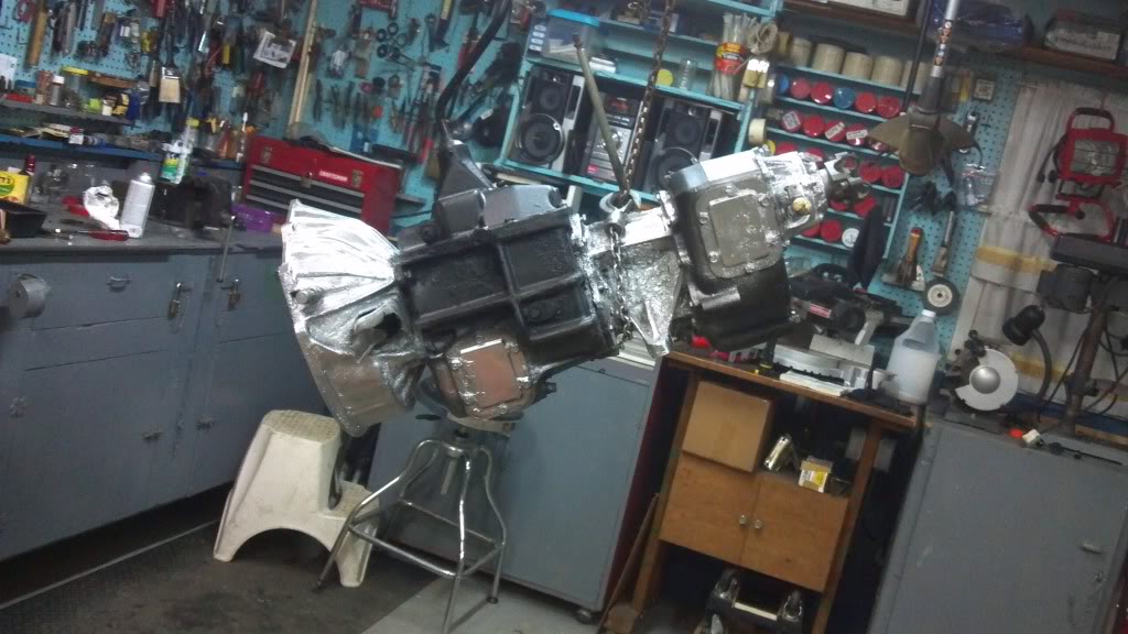

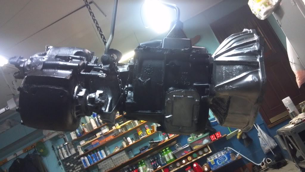

Well today i sandblasted the trans and t-case. It didnt really turn out that great the cheapo craftsman sandblaster just didnt have enough guts to get all the stuff off, i think if i would have sprayed some degreaser on it the last couple days and washed it first it would have worked but its done now.
And i cleaned up the silver overspray that was everywhere after these pics so black is where it should be and so is the silver.

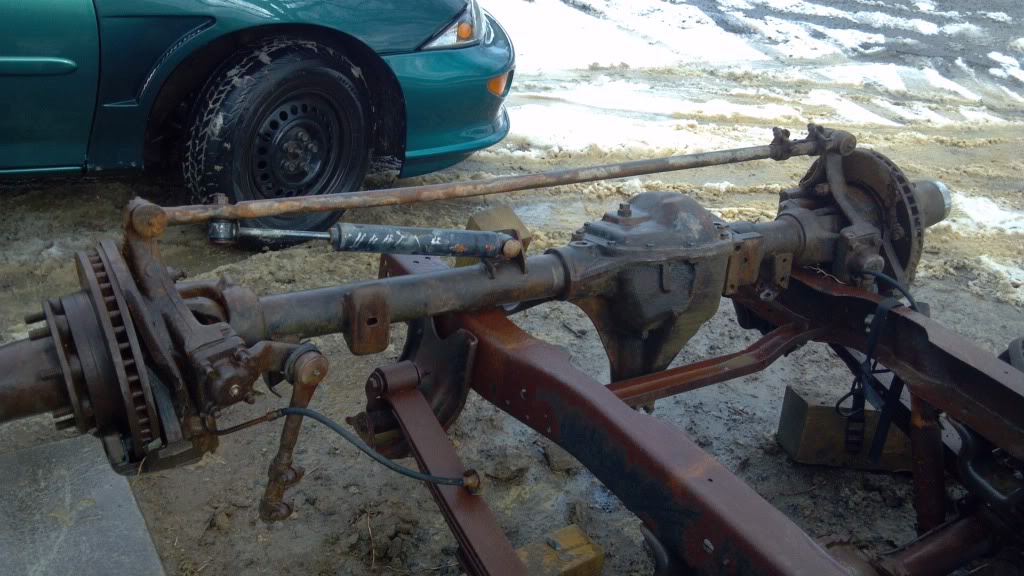

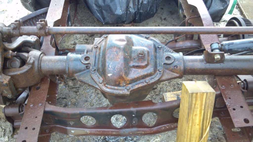

It warmed up a little bit the last couple days so i was able to clean the D60.

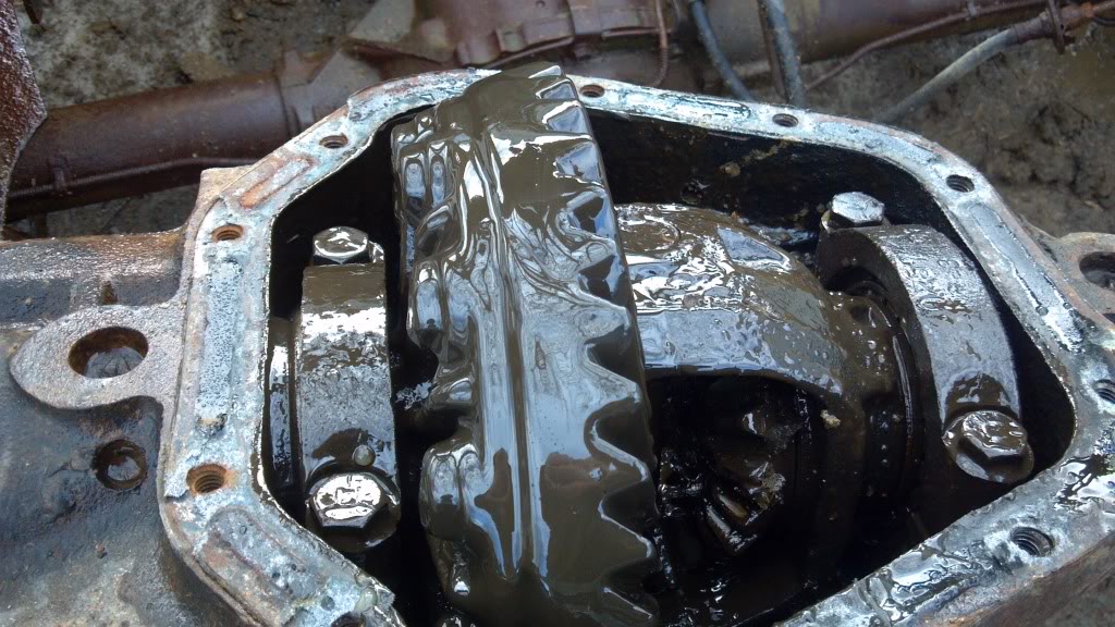

When i was pulling the diff cover off i cleaned the ratio tag and saw that it should have 4.10s in it
I continued to pull the diff cover off and what i found wasn't what i was hoping for, some nasty looking oil and a good bit of water and ice. I come to find out that the pinion seal is leaking which is still not a real big deal.
So now this axle is going to get torn down and cleaned really good both inside and out along with a nice sandblast and paint, for now im keeping the 4.10s in the front rear and not going to lock it, If i like the ratio ill put lockers front and rear if not ill change gears then do lockers, but plans for the D60 are all new brakes, clean, paint, Crossover steering and replace necessary things.
