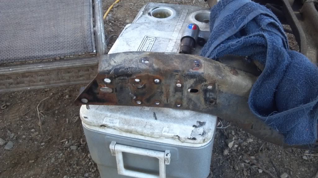

So in the last few days i was able to get the rear brackets off.
Got the frame cleaned some then primed and painted.
