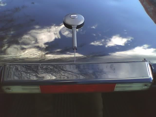

Guys and Girls, if you don't have Sirius/XM yet, I highly recommend it. Regular radio here in Vegas is pretty good but man o man, Sirius is the way to go.
Here's how I did mine:
Ran the antenna wiring under rear cargo light gasket along existing wiring (think I'm gonna dab silicone sealer around the gasket - it doesn't rain much here but I gotta wash up there SOMETIME ).
Then on the inside, I went over the windows on the driver side, pulling the trim away slightly to get it tucked up under - you don't have to unclip the trim, the wire is very thin and should just push right under the edges. I went down the front pillar to the kick panel, under the carpet, and behind the pedals.
I mounted the self-adhesive radio bracket under the dash in front of the power receptacles. You can also drill it and mount it permanently but I wanted to see how the sticky works.
The mount swivels and I can reach it without bending way over. I got the radio without a remote - I'm cheap that way - but if you splurge it's probably safer.
Anyway, I dig it. You can also opt for online streaming music - Slipknot playing right now [sm=icon_rock.gif]
