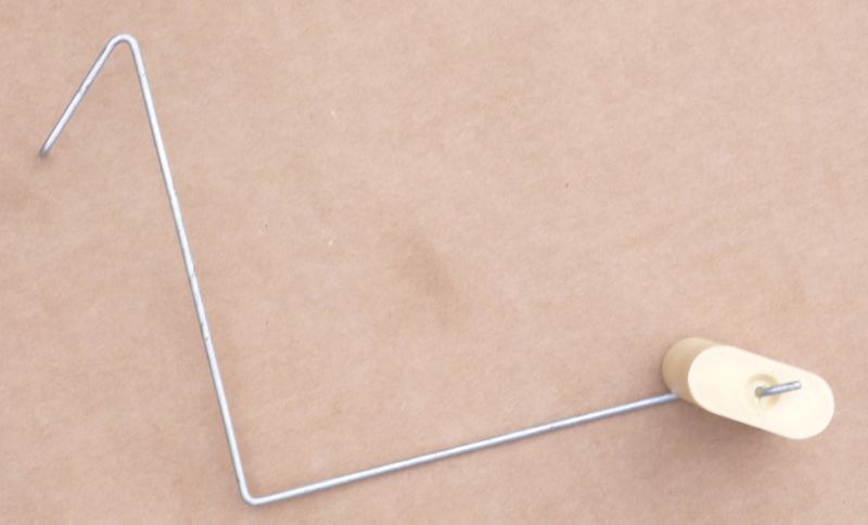

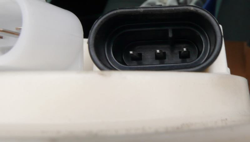

Old Sep 24, 2010 | 10:08 PM
  #15
nw chev's Avatar
Joined: Sep 2010
Posts: 47

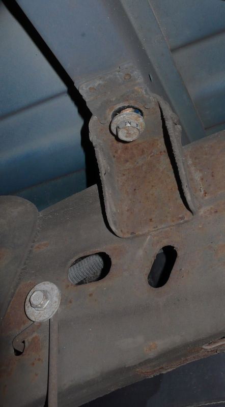

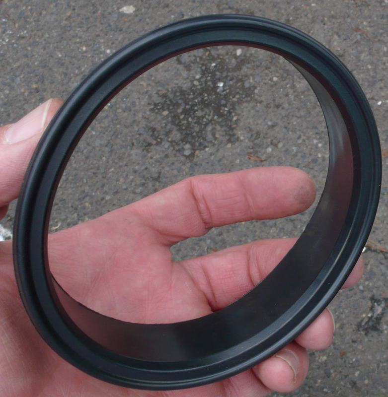

pics from the project
Attached Thumbnails stalls, no power-tp1110219.jpg   stalls, no power-tp1110220.jpg   stalls, no power-tp1110223.jpg   stalls, no power-tp1110225.jpg   stalls, no power-tp1110227.jpg

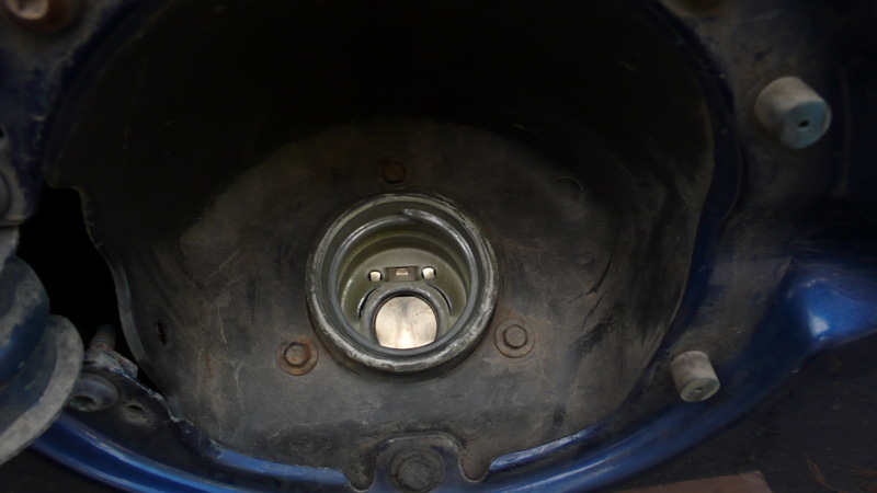

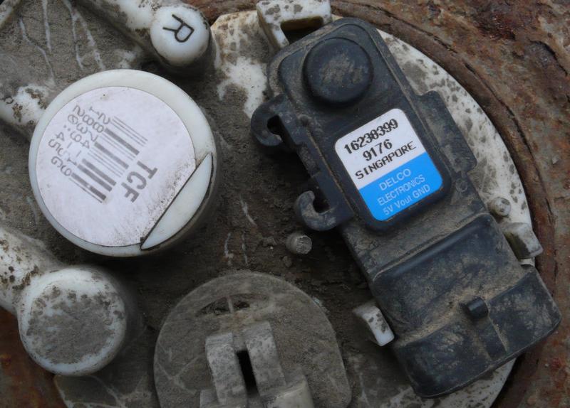

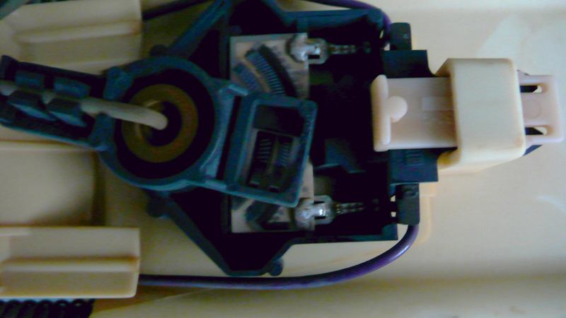

Old Sep 24, 2010 | 10:09 PM
  #16
nw chev's Avatar
Joined: Sep 2010
Posts: 47
Attached Thumbnails stalls, no power-tp1110228.jpg   stalls, no power-tp1110230.jpg   stalls, no power-tp1110231.jpg   stalls, no power-tp1110232.jpg   stalls, no power-tp1110233.jpg

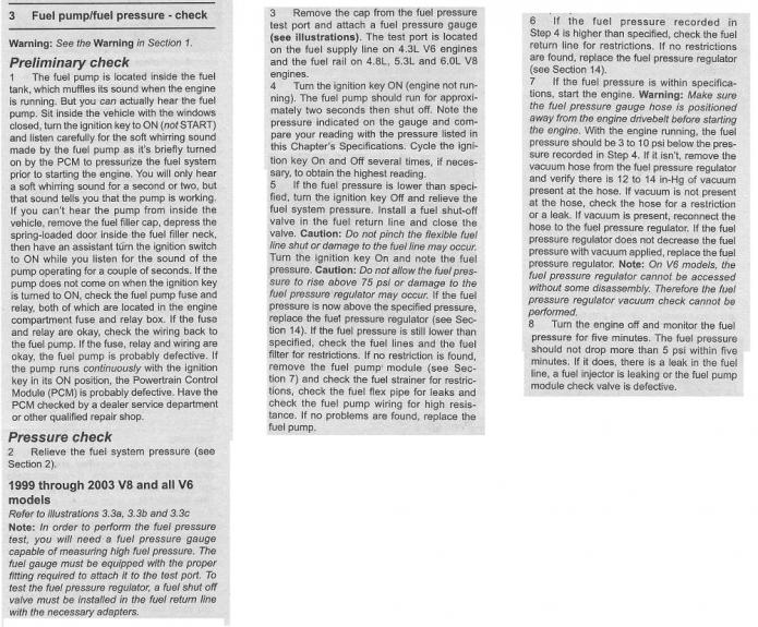

Old Sep 24, 2010 | 10:21 PM
  #20
nw chev's Avatar
Joined: Sep 2010
Posts: 47
