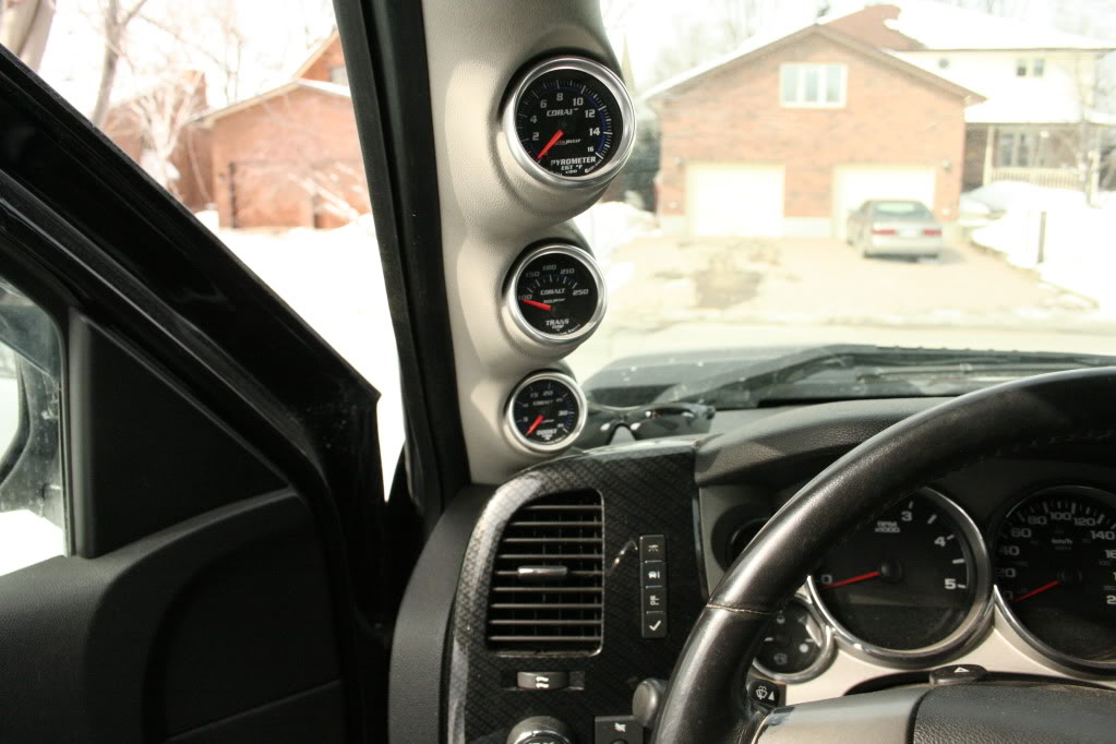

I bought an Autometer Trans Temp gauge to go in my 3 gauge piller pod.
Temp sending unit went in the lower trans cooling lines (witch is the hot line going to the trans cooler in the rad).
