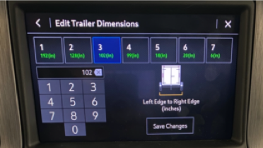

Another area I'm still sorting out has to do with how the Transparent Trailer looks on the home screen. When you set up the trailer profile, it promts you for trailer dimensions. My trailer is 9' wide (108") outer wheel to outer wheel, which is how you are prompted to input this dimension, as you see in the picture.
However, when I used that dimension, and pushed Save Changes, I received a message saying my dimensions were outside the Transparent Trailer feature limits. I played with the width dimension and found that it would accept up to 102" for the feature to work. The Transparent Trailer image is fine on my home screen, but you can see in my picture below that the upper 2/3 of the screen from side to side is from my trailer camera. The various demonstration videos show vertical transition lines on the sides of the upper 2/3 of the screen where the images from the Video Trailer Mirrors are stitched in. I don't know if one is better than the other, but I plan to play with reducing my width dimension, recalibrate, and see what it does. I'd be interested if anyone has experimented with this and what they learned.
