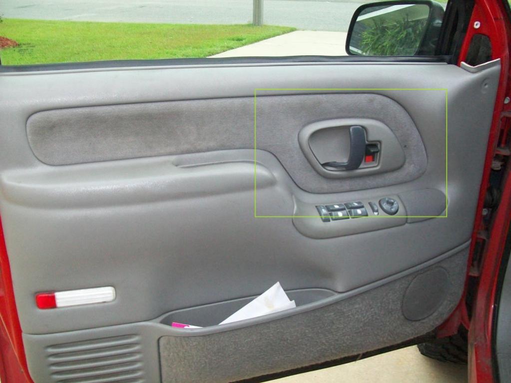

Whats the trick with the latch panel you mentioned. Nothing obvious is standing out and I don't want to break this piece.

Having just replaced my driver side door handle, heres what I did:
Remove the 2 screws. Before you can pop off the door panel, you'll need to remove that plastic oval-shaped panel where your interior door handle and locking switch is located. Behind that panel are 4 tabs (middle top and bottom, left and right); I used a thin flat-head screwdriver to push up on the tabs and painstakingly pull the thing out. Once you get that plastic interior panel off, the entire door panel itself has white plastic tabs on the backside; just use a flathead and pry the panel toward you, starting with the top left corner, they can break so be careful.
