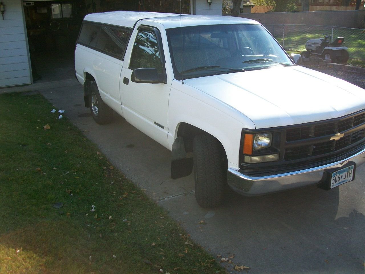

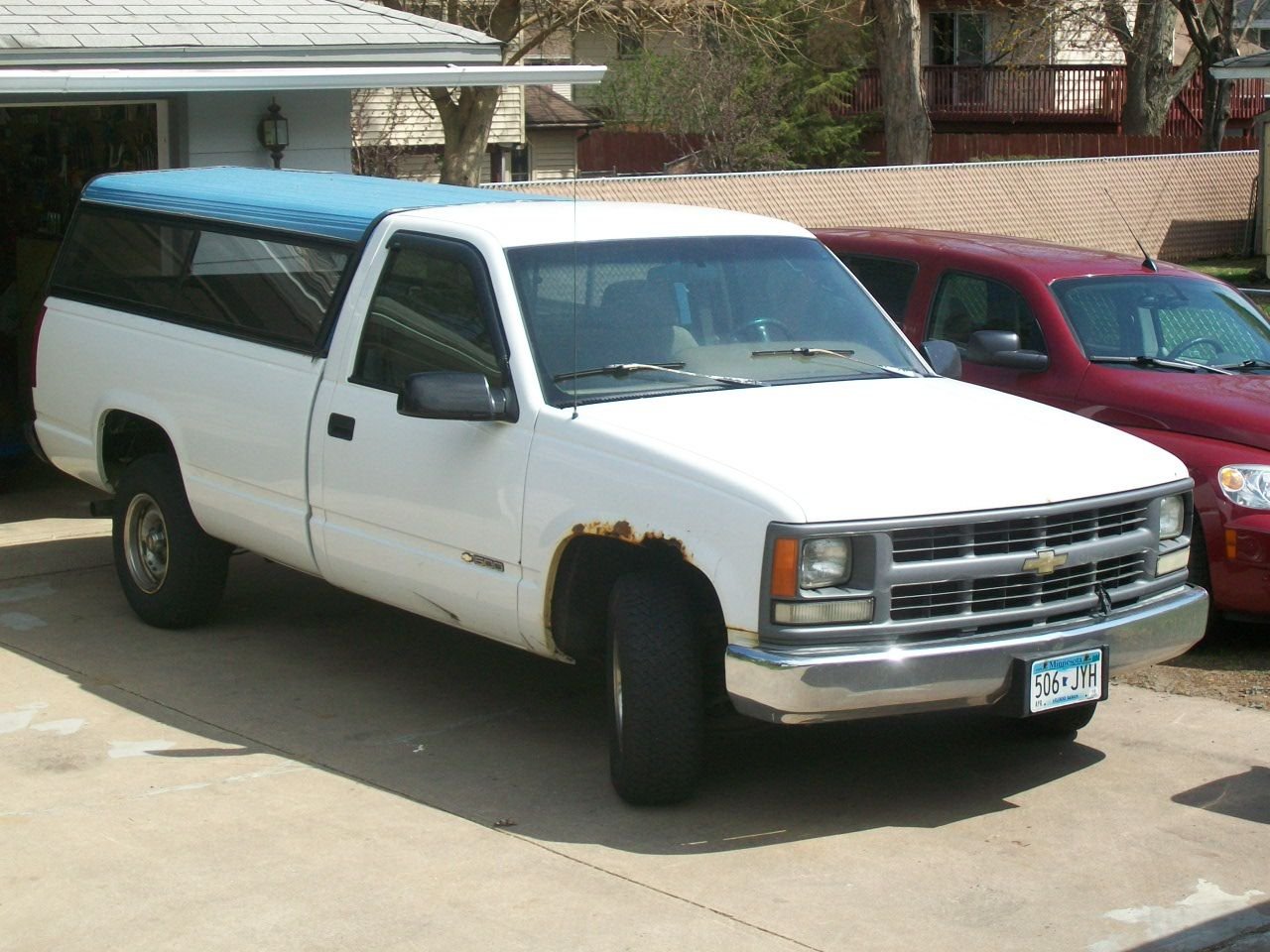

Hey.... I would just like some advice and run a procedure by everyone to see if I am missing anything... So here goes. I more/less retired from vehicle restorations because of age/arthritis and the fact that we moved from a rural area where I had a full shop to the metro area where I have a glorified heated two car garage. I didn't want a major restoration project so I bought a 1995 C1500 Chevy W/T that had a newer perfect box but needed a ton of little fixes but has less than 80,000 miles..... and they all turned out well. Now I am going to try to replace the cab corners on both sides... bought some el cheapos off Ebay and have watched a ton of videos on "how to".... but remember, I no longer have any kind of hoist or tools and don't really know enough people in our new location to get any help to lift the bed off....... so here is the plan. After watching the videos it appears there are eight bolts holding the box/bed on the frame... there is the gas tank filler tube and ground wire... and there are some electrical wires on the back end of this.... What I would like to do is to remove the bolts, and disconnect the fuel filler tube... etc... and simply use my floor jack to lift the front of the box high enough to be able to cut/weld etc new cab corners in on both sides instead of removing the entire box.... When done, simply lower the front end of the bed back in place, replace the bolts and wiring etc... and it's a done deal.... Now.... what am I missing? Suggestions/ideas very much welcome and appreciated... PS All this so I don't have to remove the box..... and can work/weld the cab corners in place....

Default pictures after two winters of work
