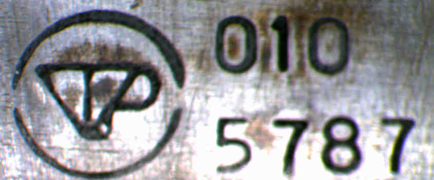

New member with a question ,of course. I have a 75 K10 with a 350 that I have pulled with the intention of rebuilding. On pulling it apart I find the attached number and logo on the rod and main bearings. I figured that the 010 means and oversized bearing but the same logo and number is stamped on the bearing caps which didn't make sense to me.
If you turn the crank and use oversize bearings to compensate what does that have to do with the cap? I would think the cap would be unchanged unless someone align bored them.
Does anyone recognize the logo? I want to be sure it's not a part number before I order oversize bearings. I may end up replacing the crank as I have heard of failures on turned cranks but want to be sure I can drop in a stock one without problems but the cap stamp is bothering me.

Get a 0-6" ID/OD micrometer and measure the ID of the main in the block to see if it was line bored.
