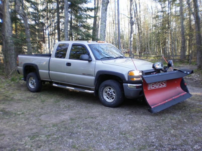

What are specifics on your truck other than engine and 2500hd? Below is a picture of what I have now. My whole motivation for a possible change is to have a less expensive reliable truck to leave at our cabin for plowing and find a small truck for my daily use around town. The truck I have now is killing me on gas for daily use.
