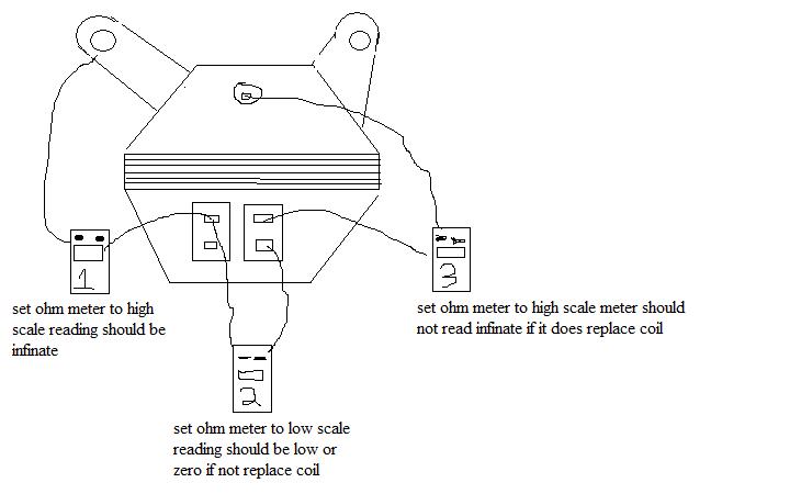

I have checked the fuel pump and heard a hum from the fuel tank area and I assume that is ok. If it is the distributor area(coil, etc) how do I tell which exactly is the problem? Do I need to buy a multimeter and if I do what would be the measurements readings, etc. I plan on buying starting fluid and spraying in the injector area and see if that starts. The funny thing about this it really tries to start and starts for a second and then dies.

to test coil look at my home made pic. to test plug wires take ohm meter and test resistance from INSIDE distributor cap to end of plag wire by spark plug resistance should not be over 30,000 ohms anything over 30,000 should be replaced however resistance should not exeed 25,000 ohms. if wires are longer than factory ones the resistance may be over these numbers. sorry if this is confusing but im copying this right out of my chiltons manual. also check the plugs to see if they are gapped correctly and or fouled out it could also be low fuel pressure
