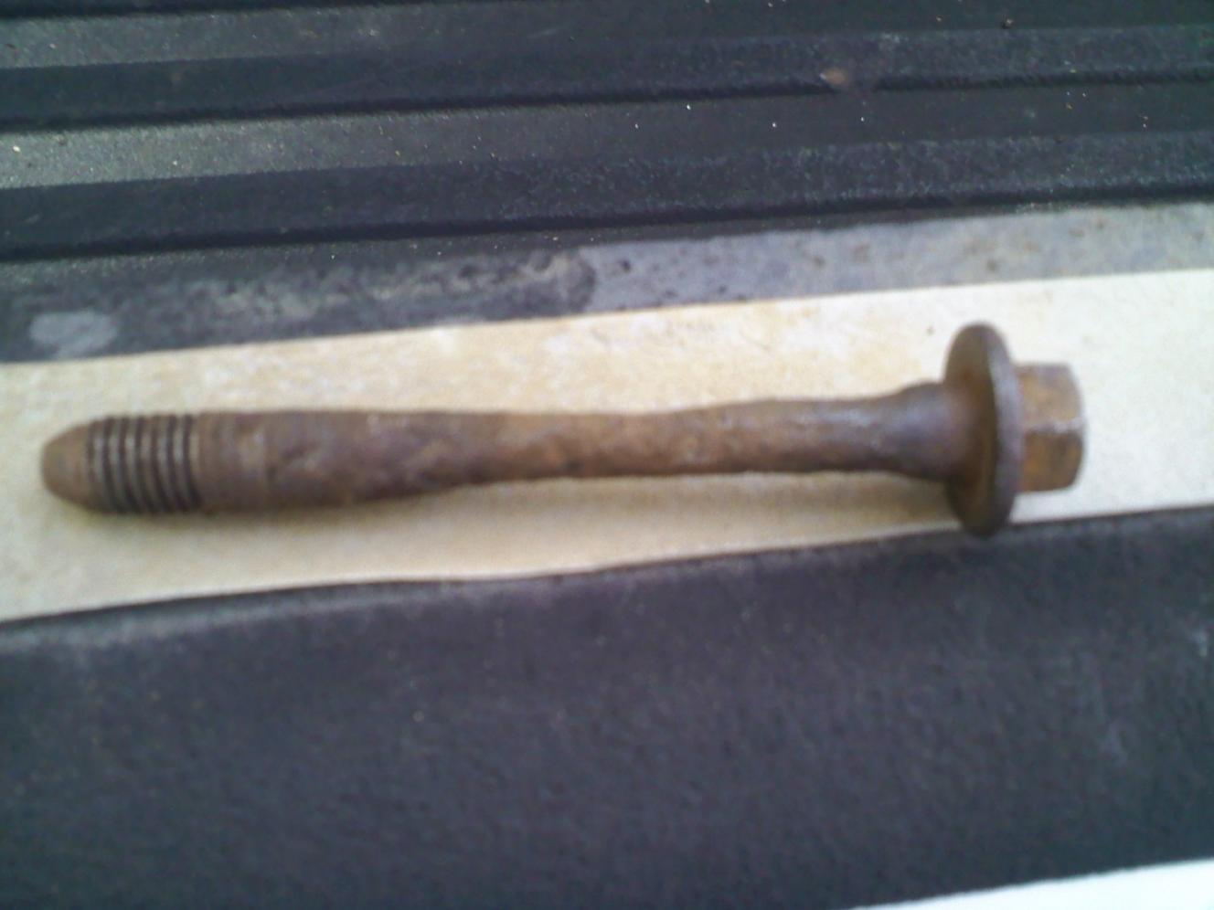

I was installing a set of nerf bars I just picked up a couple weeks ago and was undoing one of the body mount bolts, long story short it just started spining on me. So now I have broken weld nut. Does anyone know if there is a access whole inside the cab for this thing or will have to cut my own in the floor?

Ok so now that everyone knows, there IS an access panel to your body mount weld nuts.
I had to pull the carpet back a little bit and it revieled a little plate that was held down by some rubber sealer. I just cut off the sealer and the plate came right off. I got the bolt out and the nut fixed. Unfortunatly I realized I needed all new bolts and it was too late to go to the hardware store on a Sunday. So hopefully I will have them installed by the end of the week with pictures.
So much for a one hour install.
