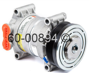

My 1996 5.0L, auto, Silverado has too much air gap in the A/C clutch plates and I was wondering if any of you know if the outer plate can be adjusted in, or pushed in closer to the magnetic plate, and exactly which tool would do this. I see those tool kits on eBay but I can't determine if any would fit my clutch shaft. Neither Autozone not O'Reilly's had that tool. Please look at the attachment to see which compressor I'm talking about, and could you ID it for me? I know it's a Delphi but that's about all I know. Man! Is it hot in Missouri!!! I need it bad!

Honestly, I would probably replace the compressor. It will come pre-set and ready to go.
Are you sure the compressor coil is getting good power and ground? It could be that your compressor is shot and all the clutch material is worn off of the plates and they're slipping. Usually you can adjust the clutch air gap by changing the shims inside the clutch/coil assembly, but I can't even begin to tell you how to do this. I know there is a special wrench to hold the clutch so you can take the nut off of the snout of the compressor, but beyond that, I really can't tell you what the spec should be, or how to adjust it without shims.

Thanks, I appreciate your advice. I've considered every option, but since the compressor doesn't leak, and the clutch is only $80 at Autozone, I may just replace that. I can just barely tap the outer clutch plate and it kicks on so I know it's only worn a bit. There's a YouTube video that shows a guy screwing a tool onto the center shaft and using a bearing to press the plate in until the gap is correct, but it he fails to mention the tool part number. Here's the link to that video:
