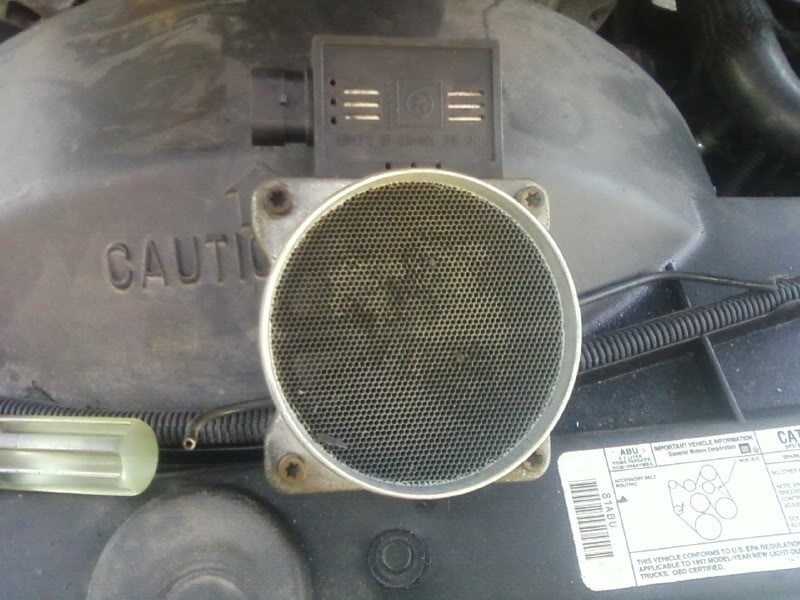

So I did the MAF descreen...it took about 5 min to do.......so here is how on the pre 99 trucks
First remove the air cleaner cover and unclip the MAF and aircharge temp sensor

then unclamp both sides of the MAF and remove
it takes a T-27 torx bit to unbolt the 2 halfs
push the screen out with a screw driver or ratchet handle (mine came out in one piece)
bolt it back together (it only goes together one way) reinstall and you are done
