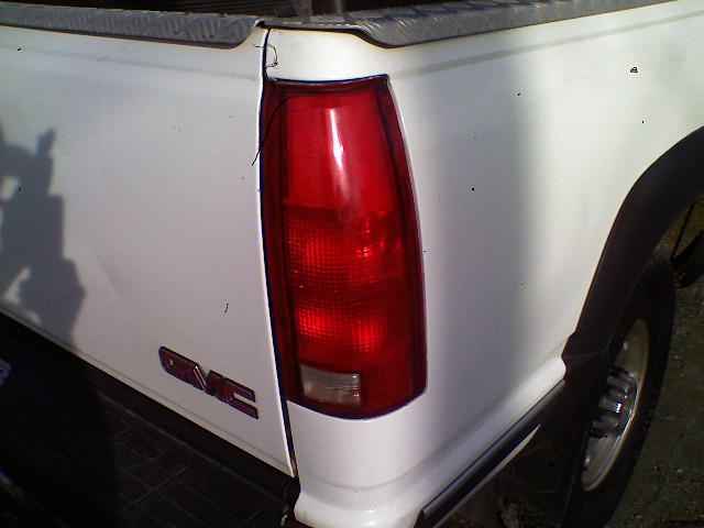

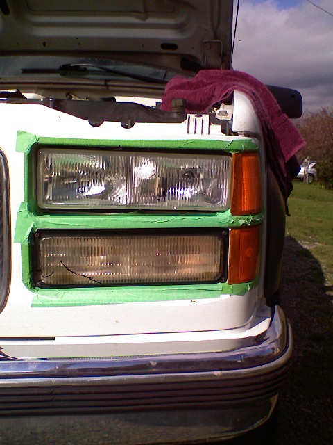

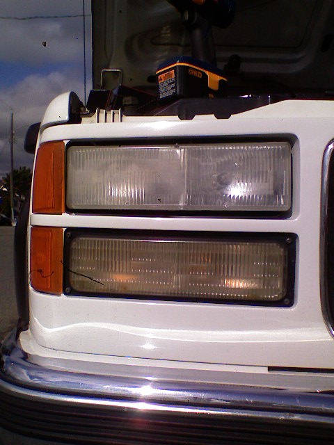

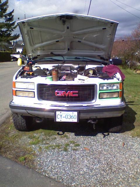

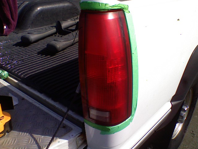

My head lights were pretty dim on this '98 K2500 I bought a few weeks ago, so I thought I would try out one of those head light restoration kits that are sold by the car polish companies. I figured if I simply put in higher output bulbs, I would still have the faded lens issue to contend with anyways. So, do the job right and polish up those lens first - then see if you need brighter bulbs!
I ended up getting the Meguires headlight restoration kit and it works pretty good. For obvious reasons, I had to spend a bunch more time on the front lights than I did the rear lights due to all the crap that has been hitting the front of the vehicle during the past 13 years of use.
I casually worked on it for about 4hrs today. The passenger side required a bunch more effort than the drivers side did, but they are both fairly equal now. I did about 4 or 5 applications on the drivers side, 7 or 8 applications on the passenger side and only 2 applications on the rear tail lights. The tail lights didn't need nearly the same attention, plus considering the application of the tail lights I wasn't too worried about them.
Here's what you'll need if you want to do this kind of a light duty project:
  1. Headlight restoration kit, available from most common autoparts stores. I chose the Mequires kit that had the liquid polish, buffing wheel/pad, and a micro fibre polishing cloth; but these kits are offered by many car polish companies.
  2. Wash and dry your vehicle first. Get rid of as much crud during the wash as you can.
  3. 3/8's drill with variable speed. I used a cordless.
  4. Painters masking tape to protect your paint surrounding the lights
  5. Beverage of your choice.
  6. Music of your choice.
  7. Dry location to do the work.
Read the directions on the kit. It's not rocket science and virtually impossible to screw up.
Enjoy the newly re-found bright headlights.
Attached Thumbnails Faded Head light lenses-1_passenger_before.jpg   Faded Head light lenses-2_driver_after.jpg   Faded Head light lenses-3_passenger_before-driver_after.jpg   Faded Head light lenses-4_rear_before.jpg   Faded Head light lenses-5_rear_after_polish.jpg
