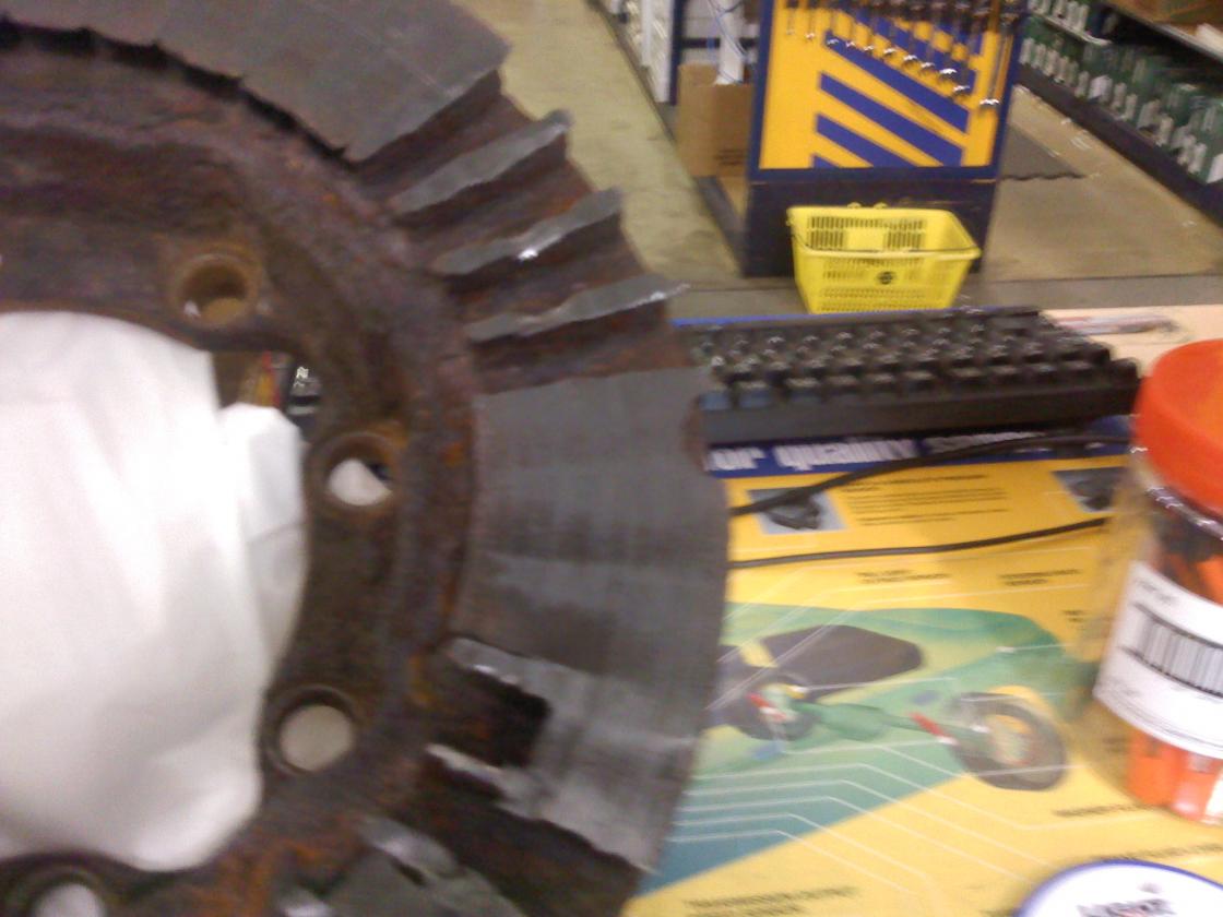

They told me it couldn't be turned

I don't see why not! LOL. I pulled a set off of a 2002 Tahoe that looked just like that a few months back. The driver was complaining about a strange noise from the rear - I guess so!

Eeeeeekk! That's crazy.

I would say someone got their money's worth out of that rotor......LOL

Wow is all I can say... Was it a guy or a woman?

On that rotor? Well I bought it just recently and decided that it felt like brakes needed to be done soon... I was right
