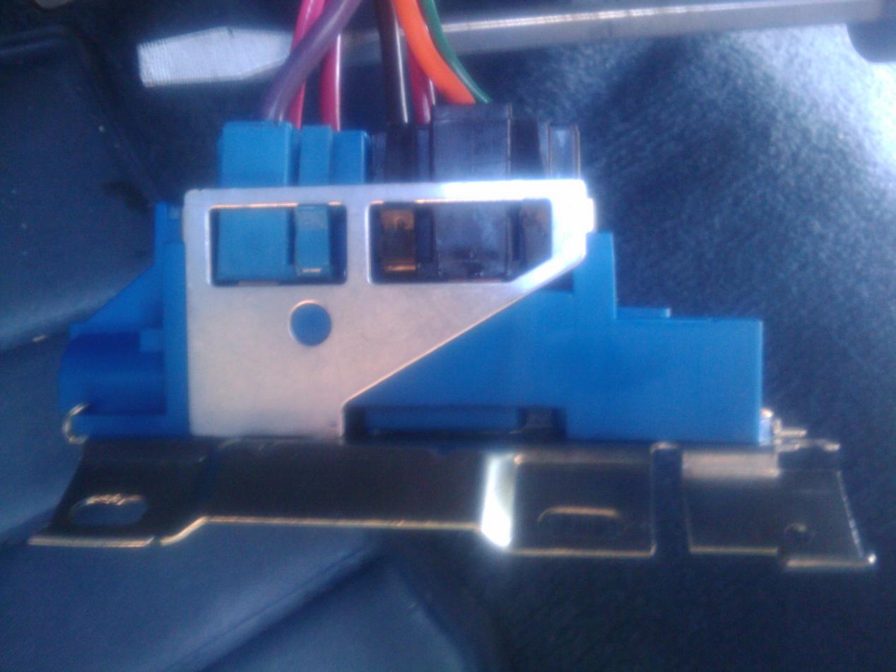

When I start my truck I can't turn it off with the key in the ignition. I can only shut it down by pulling the ignition/ecu fuse. I replaced the ignition switch with a new one and I am still having the same problem. I put the new switch in, adjusted it forward and backward to find the start and stop positions, but I can't find the stop position. So I took the switch off the column and with a screw driver I went through all the positions and I can make it start, but not stop.
What am I missing? Please help. Thank you.

so I have FINALLY figured out my ignition problem. It all reverted back to a temporary brake fix that involved a jumper wire. In the brake switch, I had jumped the red and the orange wires by having my dad solder a jumper wire between the two so my brake lights would work (my brakes lights are a whole 'nother story lol) well, just so happened that the jumper wire was keeping a constant feed of power to my ignition, not allowing the engine to shut off with the key. I clipped the jumper wire in half and wah-la! problem solved. That allowed me to turn off the ignition switch with my key in the cylinder. So buying a new ignition switch was a waste of money because the old one turned out to be perfectly fine lol, just glad it was a $9 part. Now how to fix my brake lights....any ideas?
Thanks guys for all your answers and help!
