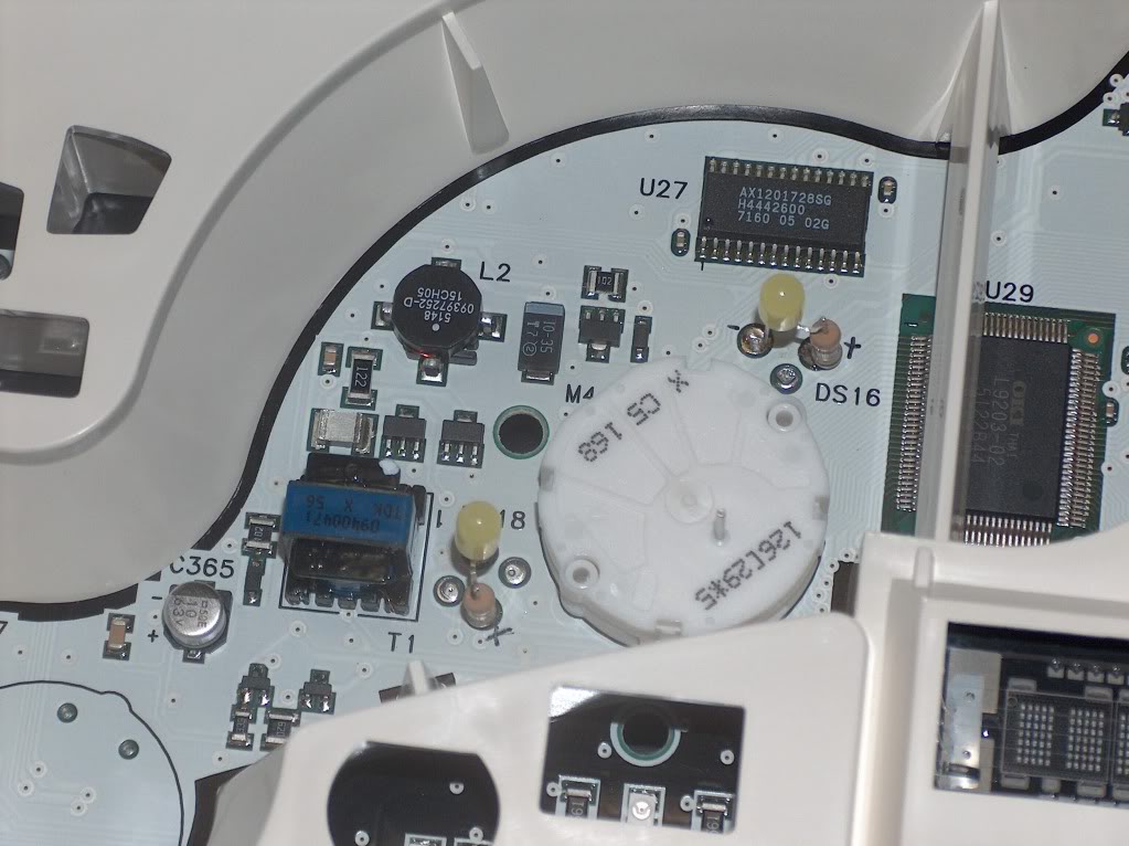

IIRC the 05 bulbs are soldered to the pc board, not like the older ones that just had the easy change bulbs. Mine is an '06 and it had the soldered in type bulbs. On my '06 the entire cluster had to be taken apart to get to them. Needles off of gauges and all. I converted them to LEDs but that is a project.
Look at this pic, the yellowish looking things are the LED's, there are two of them in this photo.
So basically even if I did get in there and pull the board out, and soldered new ones in the problems could still happen. I've seen my rear defrost button light go out completely and is now on. What is causing that? A few lights for my steering wheel control buttons also are burnt out. If I got an LED cluster would it give it problems?
