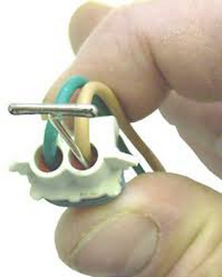

When the truck is having its no start condition, grab a test light, ground the clamp and touch the end to the purple wire on the starter - that's the smaller one with a small eyelet. If it lights when your helper turns the key to crank, then the problem lies elsewhere. If the light does not illuminate, then move back to the transmission, unplug the park/neutral switch (See below) and touch the end to the terminal that has a yellow wire behind it. Again, have your helper turn the key to crank. If it lights, plug the connector back in, and back probe (see below) the purple wire on the same connector. If it does NOT, suspect a bad park/neutral switch, or the transmission is not fully in the park position.
Slide the pin inside the insulation till it touches the metal terminal just inside the connector - never puncture wire insulation this way!
