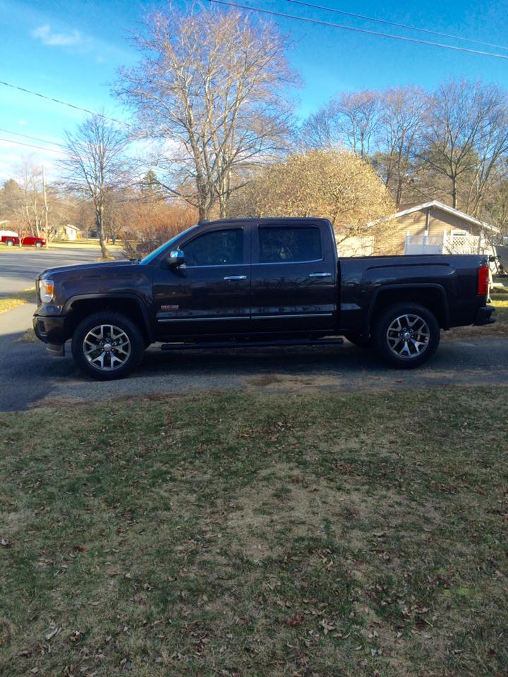

2" leveling kit 275/60r20 cooper a/t3 front is about 1/2" lower but not that noticeable, I am a little crazy so I notice it. I was parked next to 07-13 style crew cab and tops of fenders on mine are about 2" higher and hood and tailgate 3" higher. ride feels better. I don't know why these trucks don't come from factory like this
