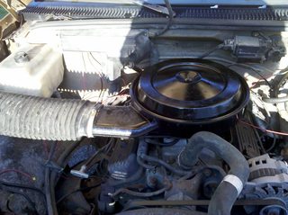

As for getting power to your setup, I'd look for a "buss bar" like I have here on my 89 truck, left of the air cleaner on the firewall, right of the coolant jug:
Remove the cover, and all of the studs behind there are all powered directly by the battery. Great place to put extra wires on. If your truck doesn't have that, you can get something like this. I use them on my truck, and they're awesome. My truck uses side posts anyways, so it wasn't a big deal to swap the posts out.
As for getting a ground, I'd find a good spot, put one of the eyelet crimp on connectors you were talking about on the end of the wire(s), drill a small hole and use a screw to screw into the frame/body where ever you need. If you don't like that, just get another battery post like I mentioned above and wire it right back to the battery ground.
