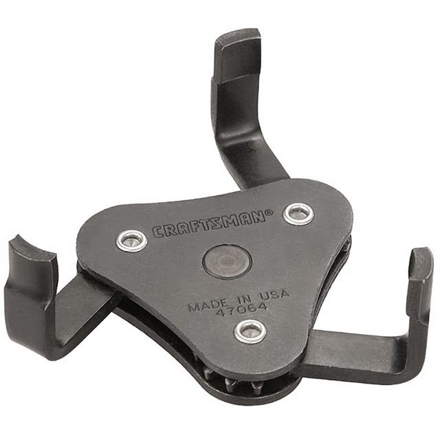

Maybe an oil filter claw will fit around the outside diameter of the sensor?

Sorry took so long to get back . So that probably would have been a good idea if I wouldn't of broke off every piece of the sensor . The best only thing left is the stud stuck in the block with just enough aluminum on it so I can't get anything thing on it to get that sucker out . Thank you for your feed back Nullhead.... Appreciate it .
