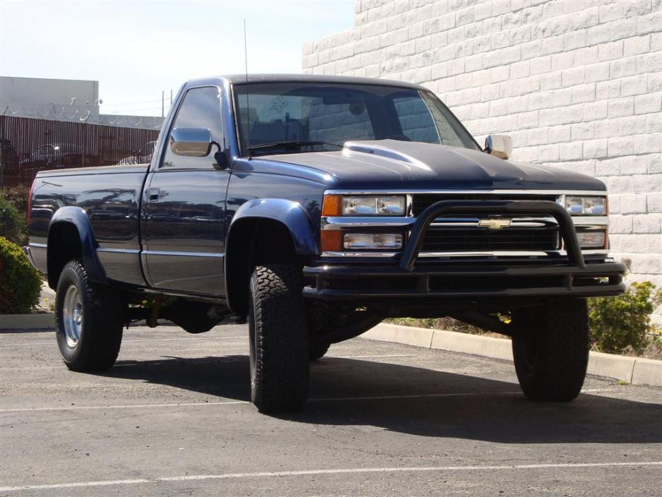

BFG 285-75/16 will fit just fine So will 315-75/16
285's mounted are only 32" You'll need to take 3/4 of an inch off the math
